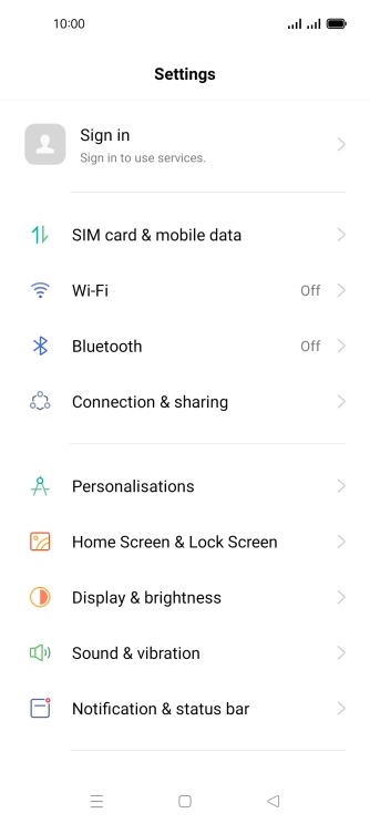

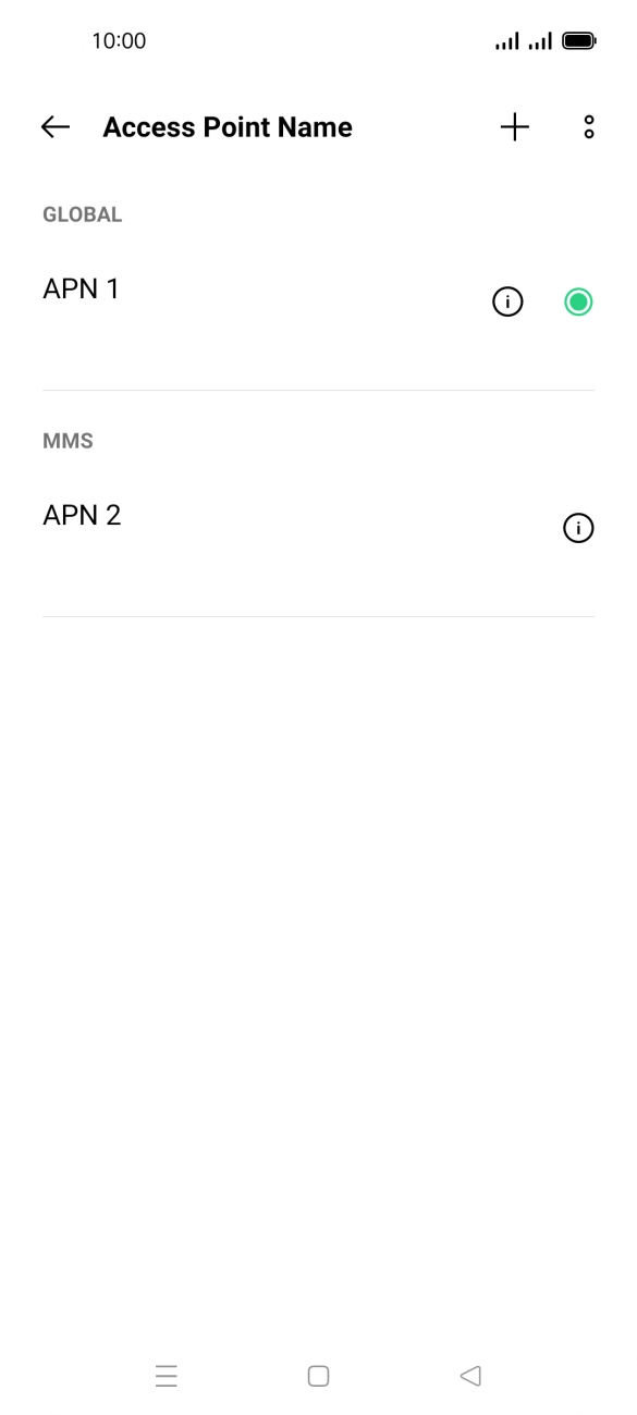

1. Find 'Access point name'

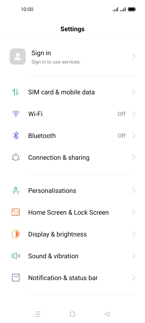

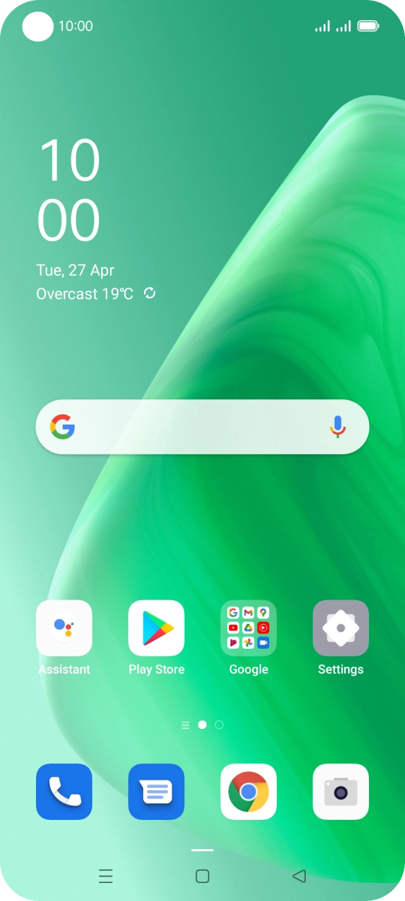

- Press the settings icon.

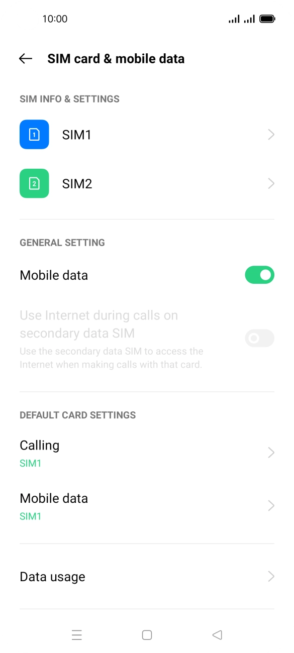

- Press SIM card & mobile data.
- Press the required SIM.

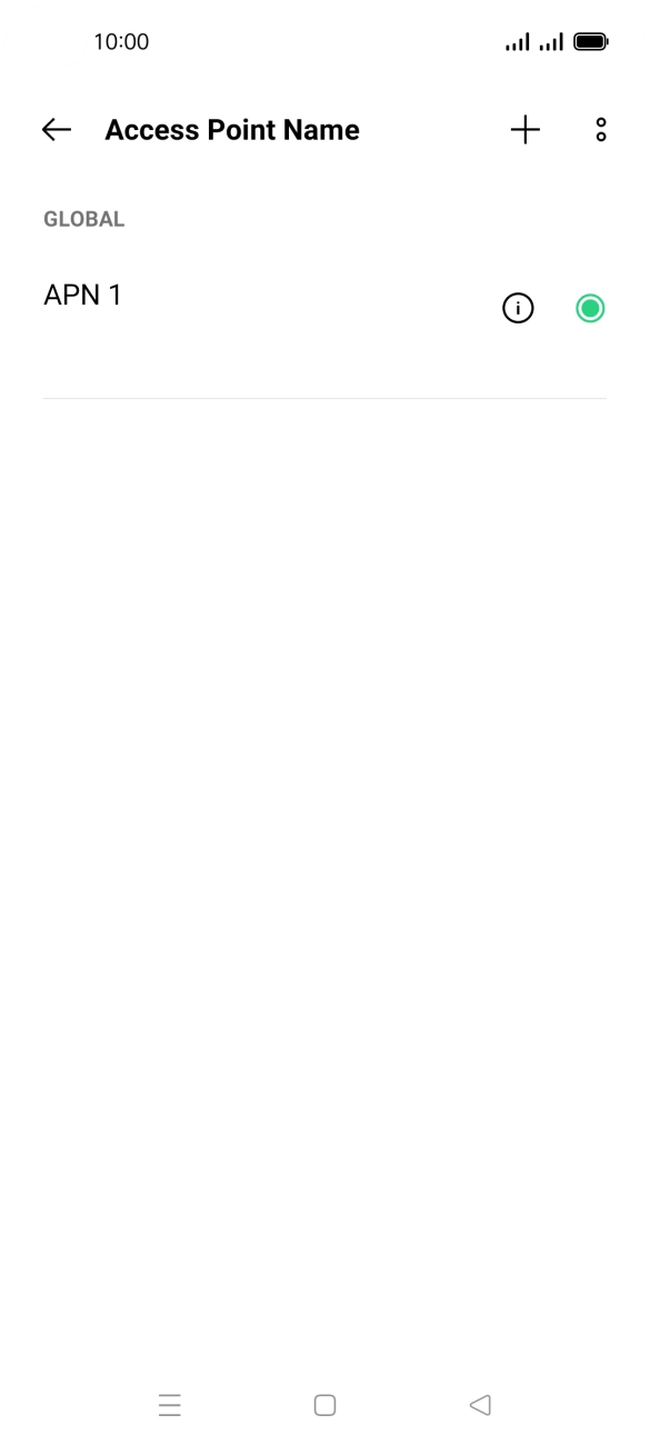

- Press Access point name.

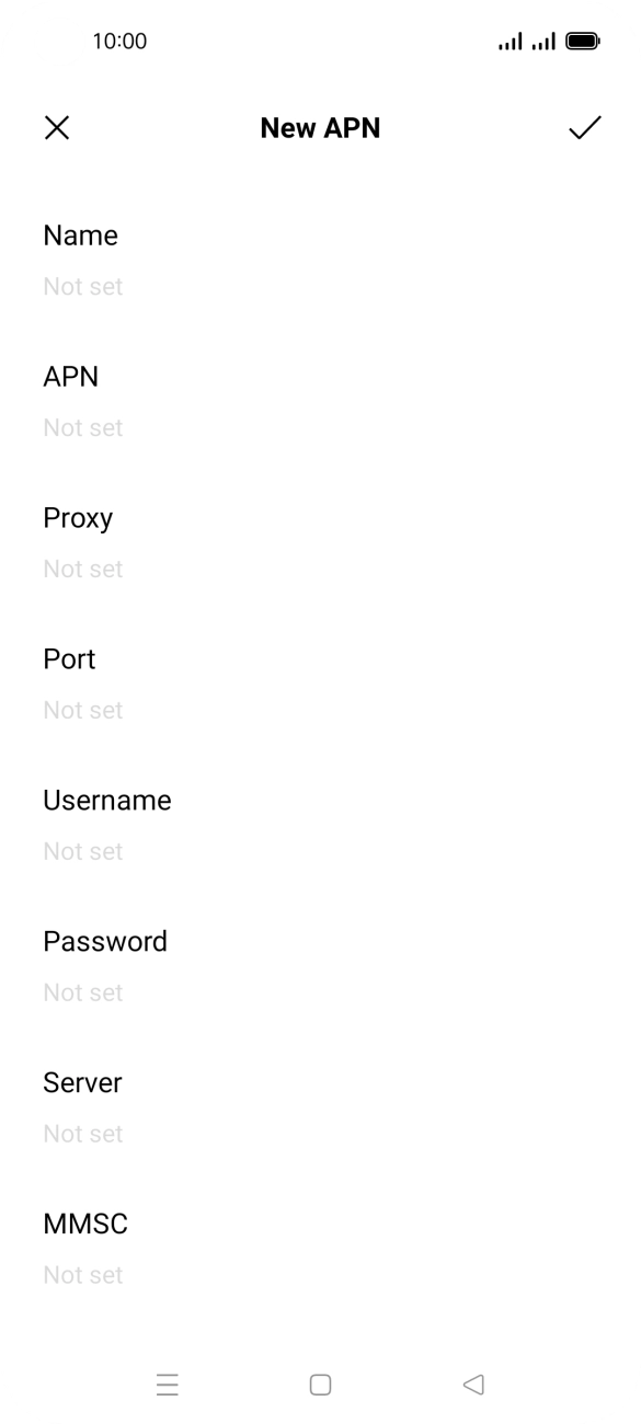

- Press the add icon.

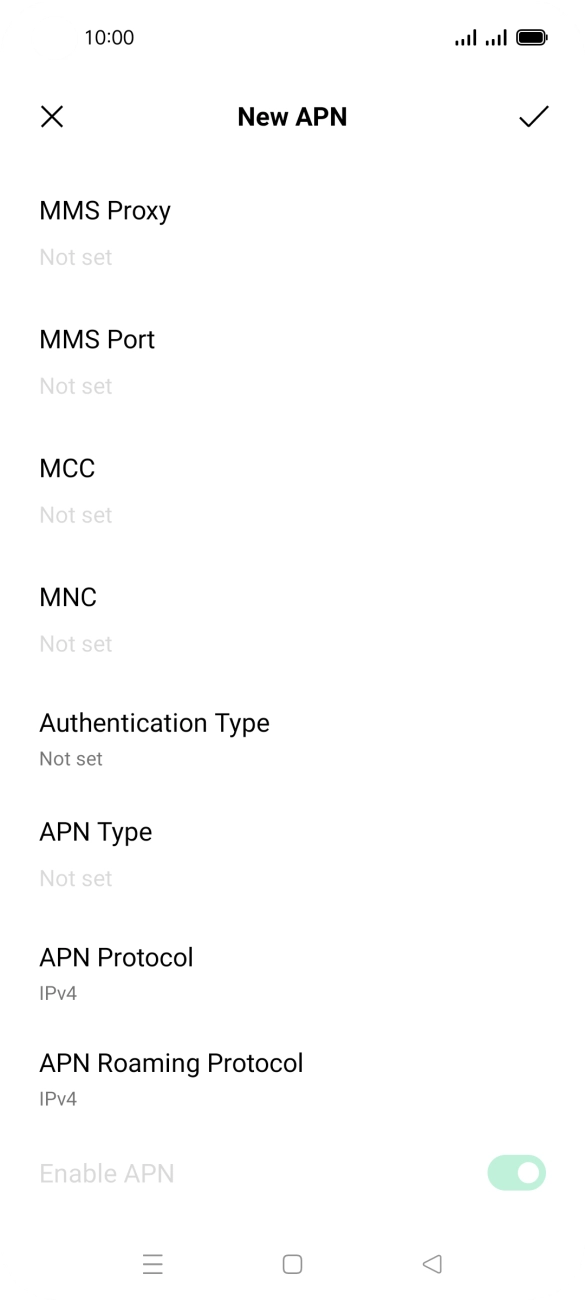

- Press the field below 'Name' and key in O2 UK MMS.
- Press the field below 'APN' and key in wap.o2.co.uk.
- Press the field below 'Username' and key in o2wap.
- Press the field below 'Password' and key in password.
- Press the field below 'MMSC' and key in http://mmsc.mms.o2.co.uk:8002.
- Press the field below 'MMS Proxy' and key in 82.132.254.1.
- Press the field below 'MMS Port' and key in 8080.
- Press the field below 'MCC' and key in 234.
- Press the field below 'MNC' and key in 10.

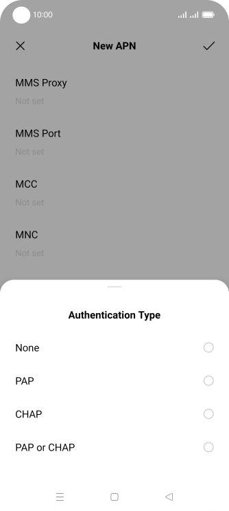

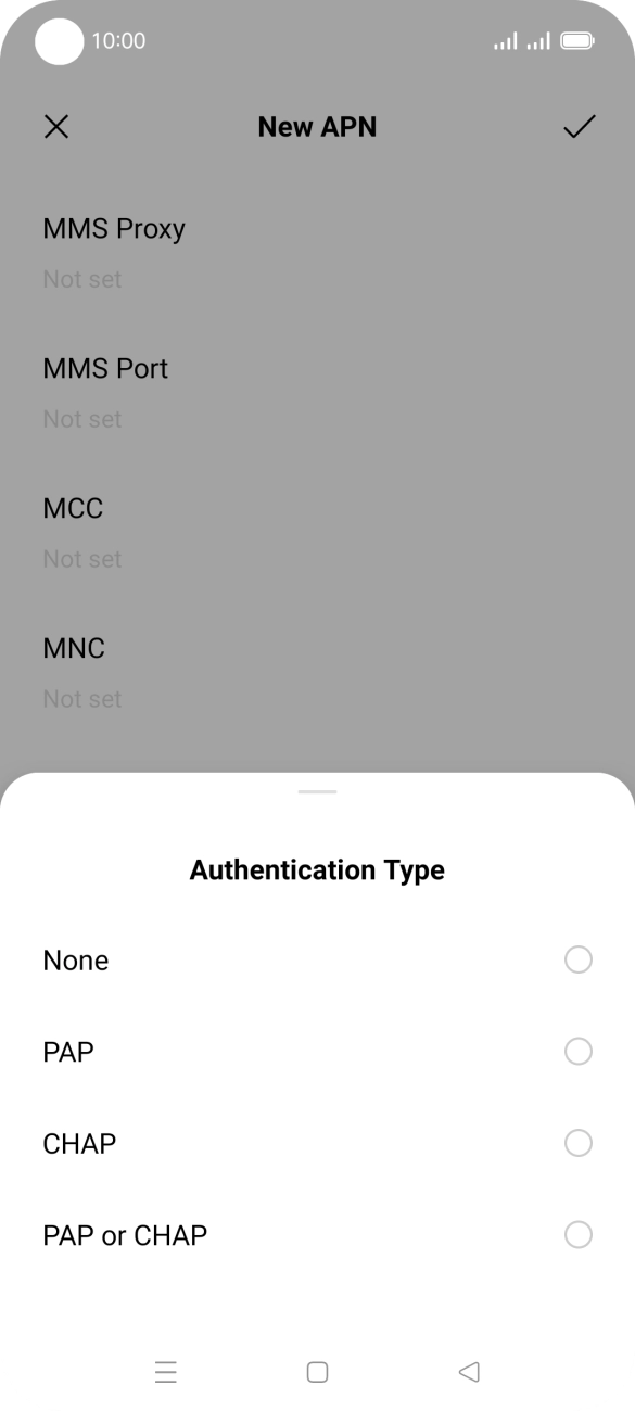

- Press Authentication Type.
- Press PAP.
- Press the field below 'APN Type' and key in mms.
- Press the confirm icon.

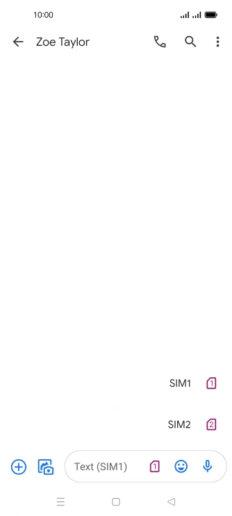

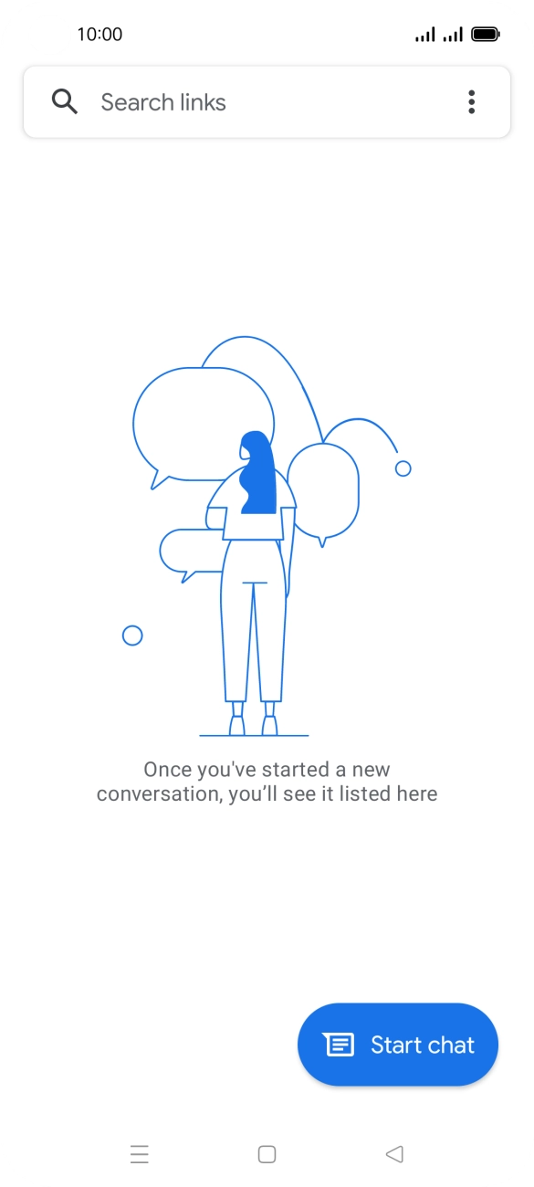

- Press the message icon.

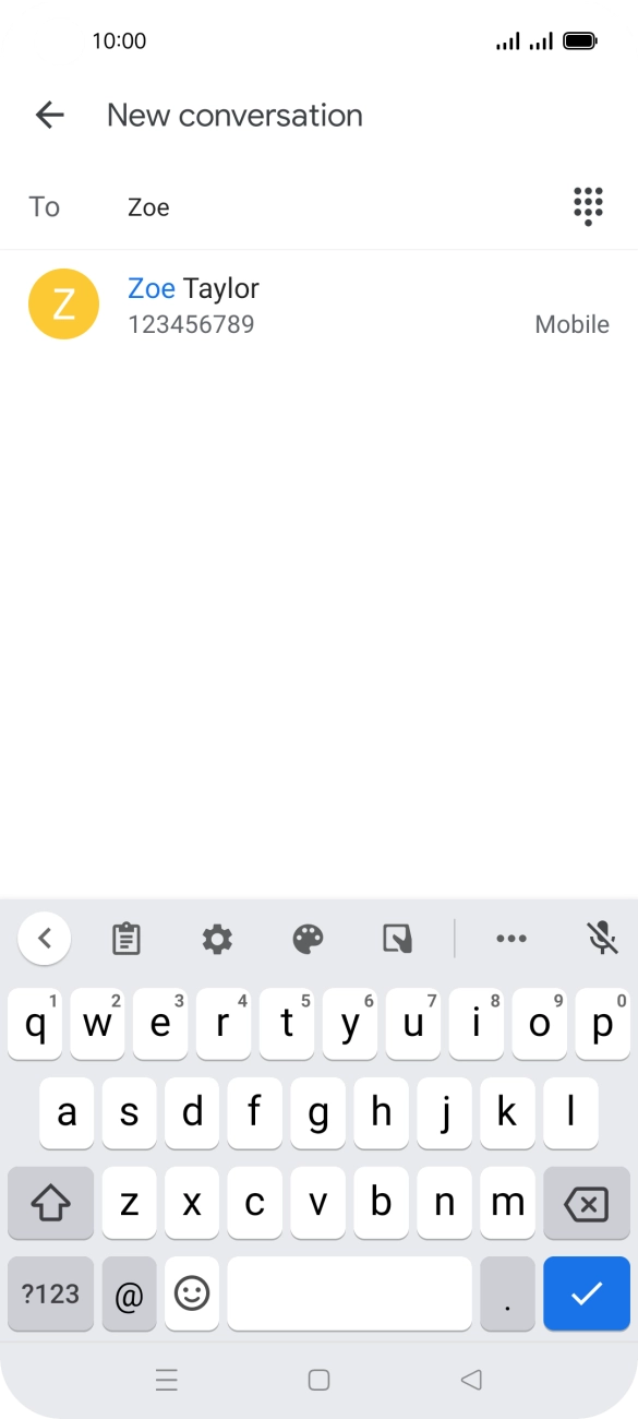

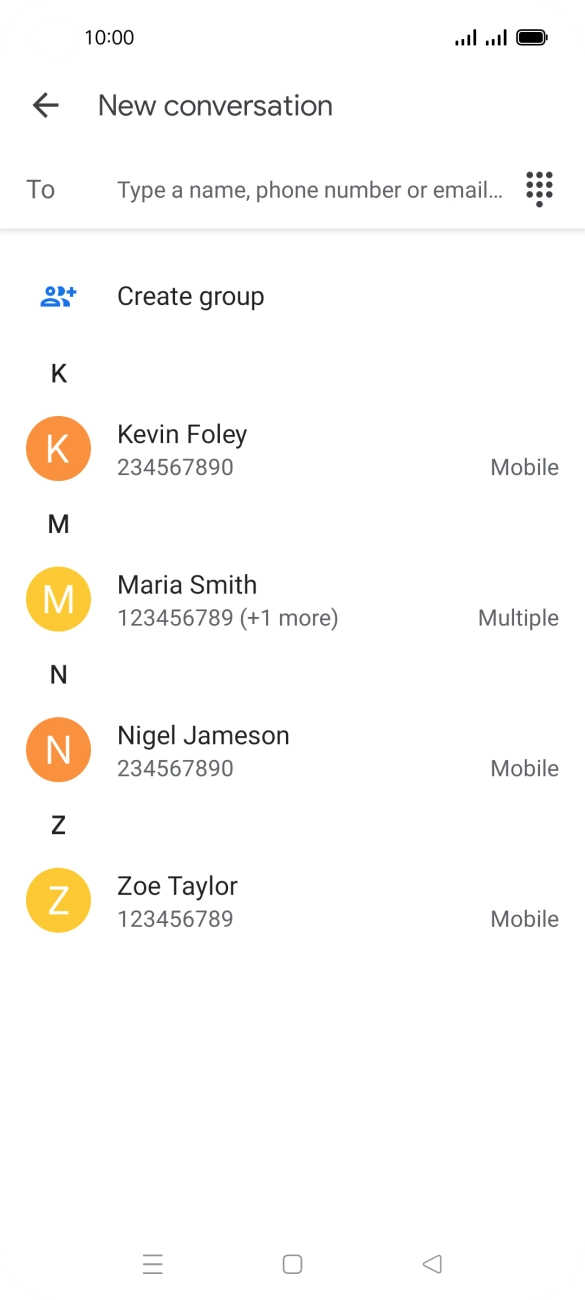

- Press Start chat.
- Press the search field and key in the first letters of the recipient's name.
- Press the required contact.

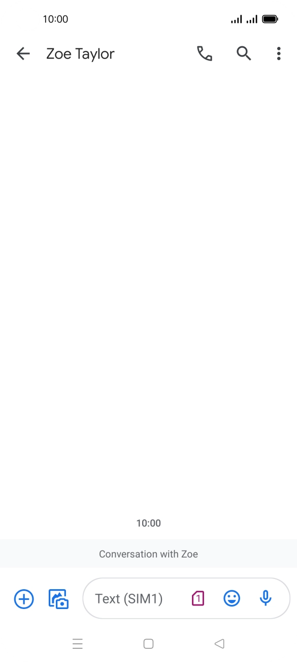

- Press the SIM icon.

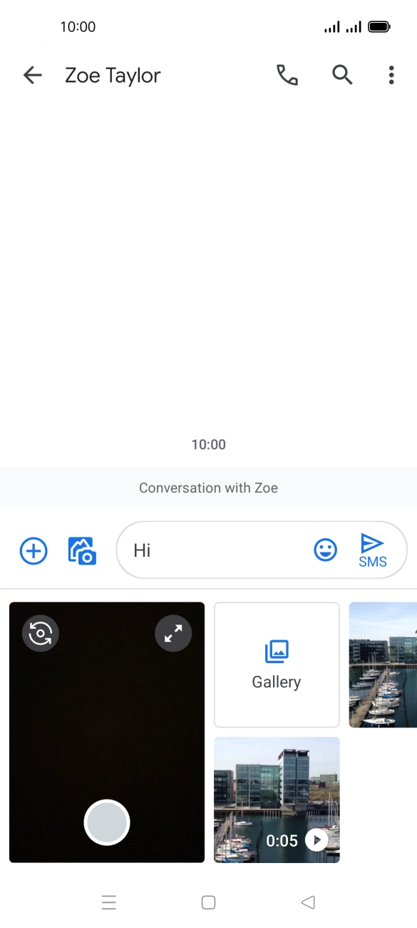

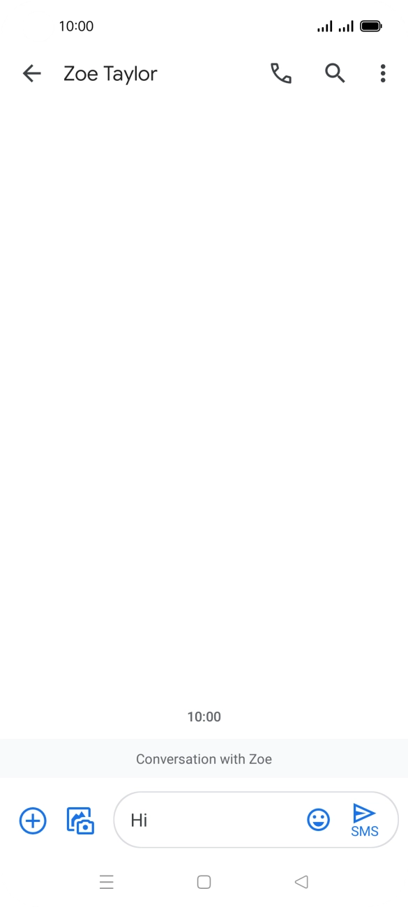

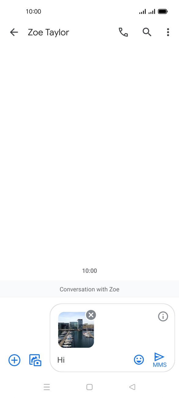

- Press the text input field and write the text for your picture message.

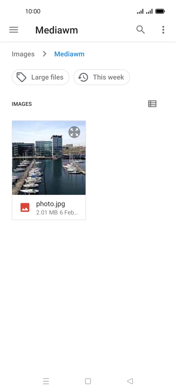

- Press the gallery icon.
- Press Gallery and go to the required folder.
- Press the required picture.
- Press the send icon when you've finished your picture message.

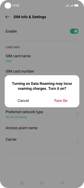

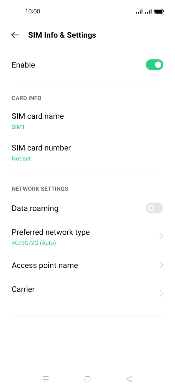

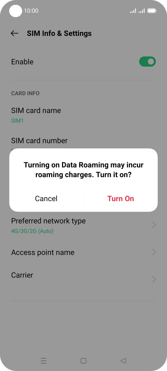

1. Find 'SIM card & mobile data'
- If you turn on the function, press Turn On.
