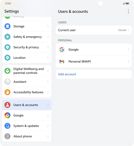

- Press the settings icon.
- Press Users & accounts.
- Press Add account.
- Press Personal (IMAP).

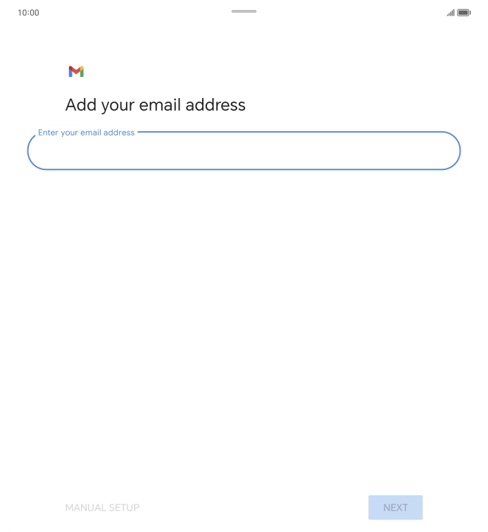

- Press the field below 'Enter your email address' and key in your email address.
- Press Next.

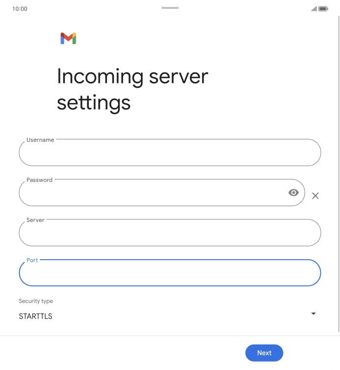

- Press the field below 'Username' and key in the username for your email account.

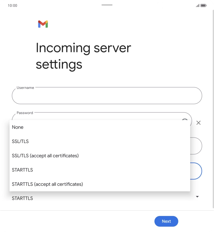

- Press the field below 'Server' and key in the name of your email provider's incoming server.
- Press the field below 'Port' and key in 993.
- Press the drop down list below 'Security type'.
- Press SSL/TLS.It's recommended that you turn on encryption of incoming emails so that all emails you receive are encrypted and secured in the best possible way.
- Press Next.

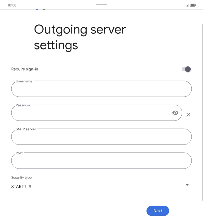

- Press the indicator next to 'Require sign-in' to turn on the function.

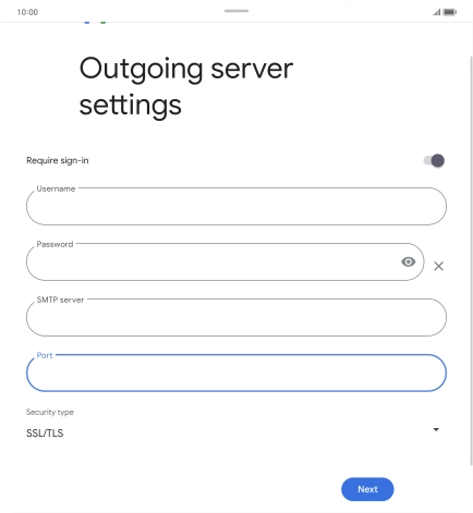

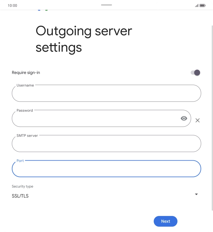

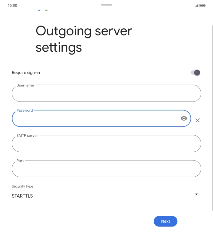

- Press the field below 'Username' and key in the username of your email provider's outgoing server.
- Press the field below 'Password' and key in the password of your email provider's outgoing server.
- Press the field below 'SMTP server' and key in the name of your email provider's outgoing server.
- Press the field below 'Port' and key in 587.If you're having problems sending emails, try keying in 465 instead or ask your email provider for the correct outgoing port.

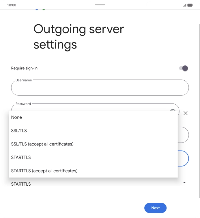

- Press SSL/TLS.It's recommended that you turn on encryption of outgoing emails so that all emails you send are encrypted and secured in the best possible way.
- Press Next.

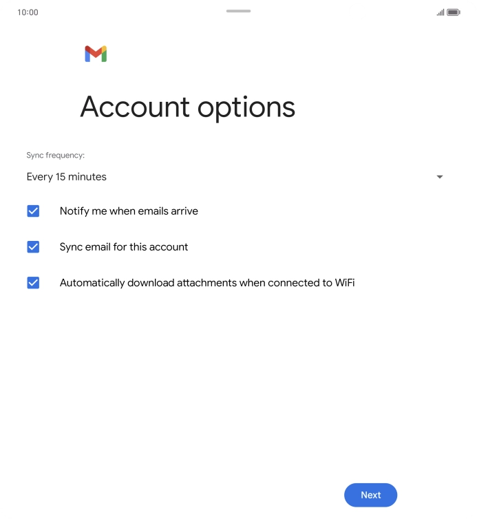

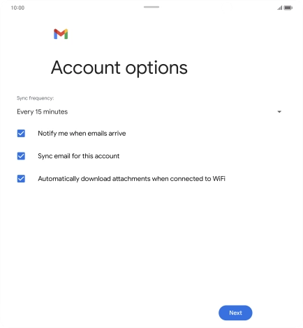

- Press the drop down list below 'Sync frequency:'.
- Press the required setting.
- Press the field next to 'Notify me when emails arrive' to turn the function on or off.
- Press the field next to 'Sync email for this account' to turn on the function.
- Press Next.

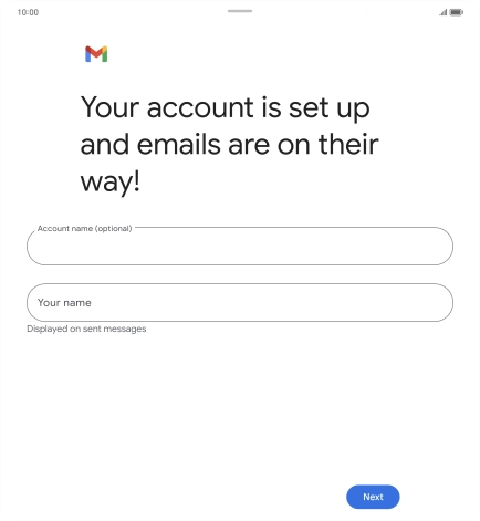

- Press the field below 'Account name (optional)' and key in the required name.
- Press Your name and key in the required sender name.
- Press Next.
