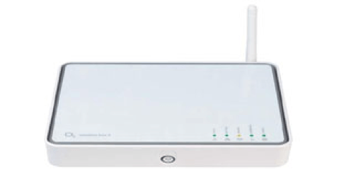

- What do the lights on my O2 router mean?
Light Colour State Meaning Power Green On Your O2 router’s on and working normally Power Red On Your O2 router’s on, but a problem's been found Power Orange On Your O2 router’s starting up Power Off Off Power off Ethernet Green Flashing A computer is plugged into your O2 router and being used Ethernet Green On A computer is plugged into your O2 router but not being used Ethernet Off Off Nothing's connected with a cable WLAN Green Flashing Something's connected to your O2 router with WPA encryption on WLAN Green On There's no wireless activity, but WPA encryption’s on WLAN Amber Flashing Something's connected to your O2 router with WEP encryption on WLAN Amber On There's no wireless activity, but WEP encryption's on WLAN Red Flashing Something's connected to your O2 router but there’s no encryption switched on WLAN Red On There's no wireless activity, and no encryption's switched on WLAN Amber and red Flashing alternating colours A wireless connection to a new computer is being created WLAN Off Off Wireless connections are turned off Broadband or DSL Green Flashing You're connected to O2 Business Broadband and the connection is being used Broadband or DSL Green On You're connected to O2 Business Broadband, but the connection’s not being used Broadband or DSL Off Off No broadband line found Internet Green Flashing You're connected to O2 Business Broadband and the connection is being used Internet Green On You're connected to O2 Business Broadband, but the connection's not being used Internet Red On Your O2 router has failed to connect to O2 Business Broadband Internet Off Off No broadband connection - Why can’t I connect to my wifi?
